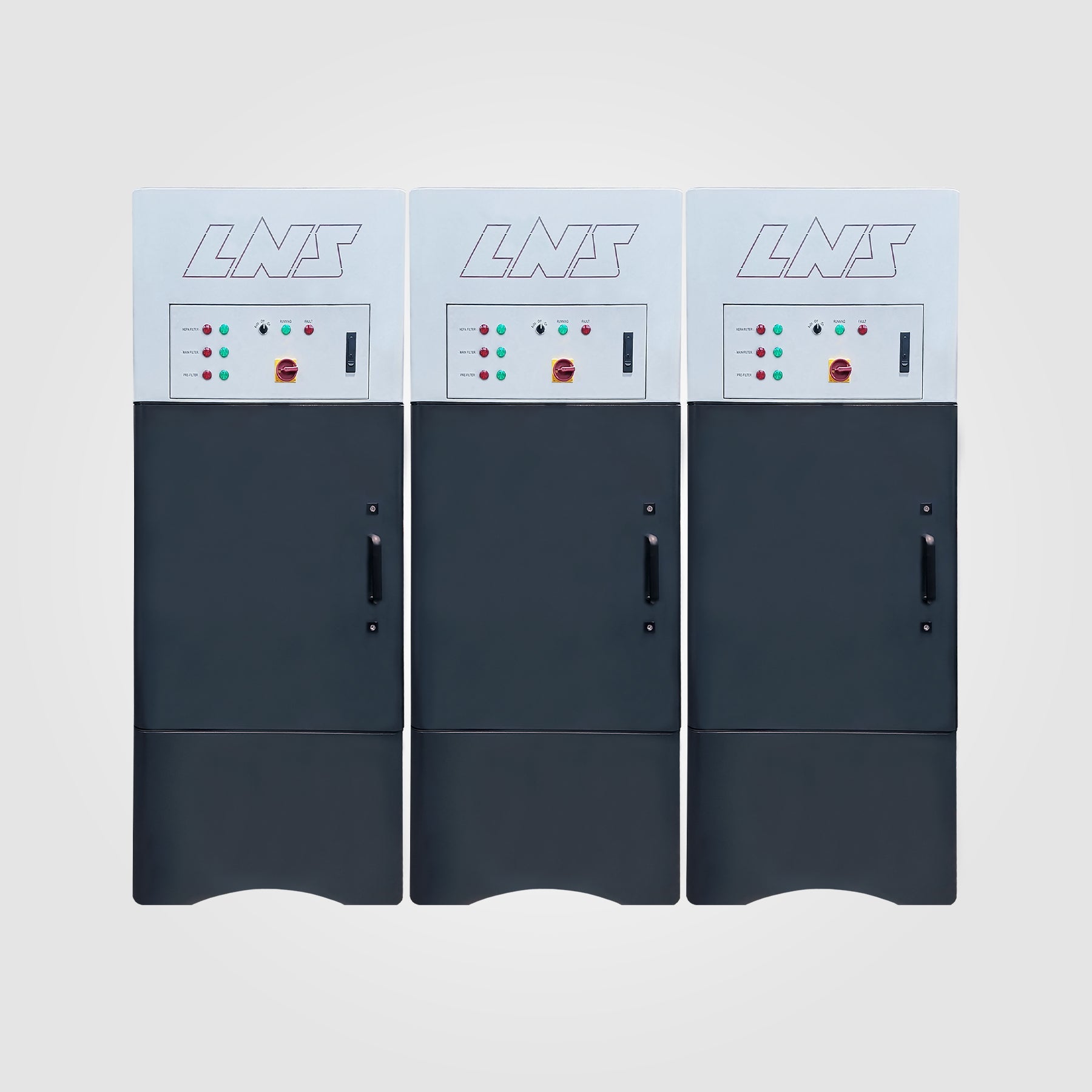

The LNS Fox WM2 series Oil/Coolant Mist Collector is specifically designed for machine tools that enclose more than 400 ft3. Additionally, these units can handle the grouping together of machines like a centralized system to eliminate mists, aerosols and smoke of wet machining operations using water-soluble or straight oil for coolant. Even more, the standard configuration provides a high level of air filtration exceeding OSHA and NIOSH guidelines for industrial air quality.
#2500
  • Air flow** [cfm]: 2350
  • Static pressure [in of WC]: 9.2
  • Motor [hp]: 4.8
  • Amps [230V]: 10.6
  • Weight [lb]: 551
  • Sound level [dB(A)]: 79
  • Inlet Diameter [mm | in]: 250 (10)
** With HEPA filter installed All units painted in RAL 7035/7016 Information is subject to change without notice
#5000
  • 2 FOX WM2 2500 Units
  • Motor [hp]: 4.8
  • Amps [230V]: 10.6
  • Weight [lb]: 551
#7500
  • 3 FOX WM2 2500 Units
  • Motor [hp]: 4.8
  • Amps [230V]: 10.6
  • Weight [lb]: 551
